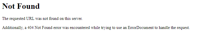

Thanks for the response but that URL doesn't exist in our environment.

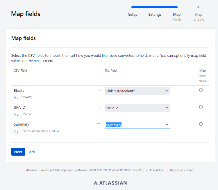

It's basically three fields and I tried a variety of permutations:
  • Summary (left blank and populated with the existing issue summary)
  • Issue ID
  • Blocker ID
I tried swapping the Issue ID and Blocker ID; I also tried using different Link Types (Blocks vs. Dependency etc) with poor results.
If I leave Summary blank (which has worked in the past and is documented in the instructions) I get an error that the issue can not be created or I get a message that says at least one issue not found (both issues are in my project).  If I populate the Summary with data, the import ends up creating a new issue.
I just want to update links through the import tool on existing JIRA issues.  Has me pulling my hair out.

In your import process, you should be prompted with a screen to map the fields.  Are you making sure that your map looks like this:
  • Issue ID = Issue Key
  • Summary = Summary
As I understand it, the Summary field cannot be left blank.

"Issue Key" is not an available field in my instance.  I was using "Issue ID"

The article I referenced above indicates that Summary can be left blank if the issue exists but it must be included in the CSV.  Either way - I tried blank and populated and failed.

You need to change the Jira ID to Issue Key.  Issue ID is a system generated ID and will always assume a new issue being created.

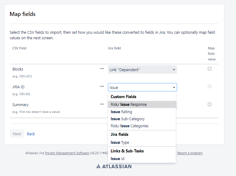

Issue Key is not an available option in the import map.  Could it be a permissions issue?

It may just be Key.  Sorry, it's been a while since I did my last import.
Leo Acosta
October 20, 2022
Don't be sorry.  I really appreciate you trying to help.  There is no field exposed with the word "Key" in it anywhere in the mapping screen.
