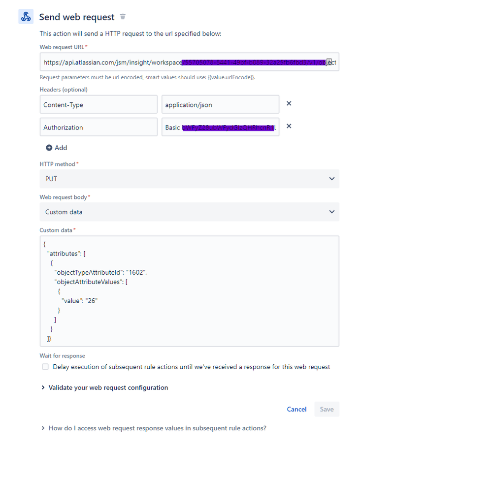

We are having the same problem at the moment, get 200 response but insight object isn't updated
We have the code working in automation, but when using scriptrunner the insight object isn\t updated.
