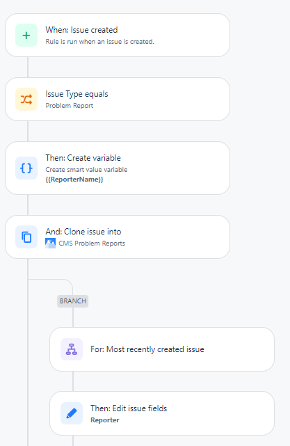

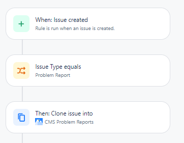

I have an automation rule that clones an issue when it is created into a different project area.

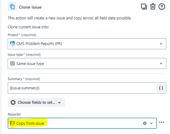

I have chosen "Reporter" as a field to set during cloning, and set it to "Copy from issue" (shown below), also tried "Copy from trigger issue". I also created a variable "ReporterName" and tried to set it with that smart value.

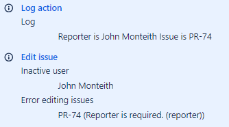

I also tried to edit the Reporter field once the issue was created, I have admin level permissions including Modify Reporter.

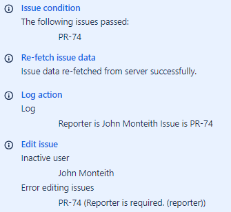

I inserted an audit log just before the Edit Issue Fields action and the issue key and variable were correct. but this is the error I am getting:

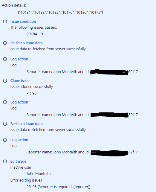

After the Re-fetch Issue action, please add a Log action to show this:
Reporter name: {{triggerIssue.reporter.displayName}} and id: {{triggerIssue.reporter.accountId}}
Re-test and check if that matches what you expected.

I actually took your suggestion and put that log entry in 3 places to see if it changed anywhere. The name and id are consistent, and the Id is mine.

I decided to see what happened if I changed "Reporter" from a required field to an optional field. The trigger issue when it is created still captures my name as the reporter. But when I try to set the reporter value during the cloning action I get the same error as before. However if I try to edit the reporter field after the cloned issue is created, the Reporter value does change, however it is changed to "Anonymous". not the value I supplied. I think the problem lies in that I am deemed an "inactive user" and I don't know what is causing that.
