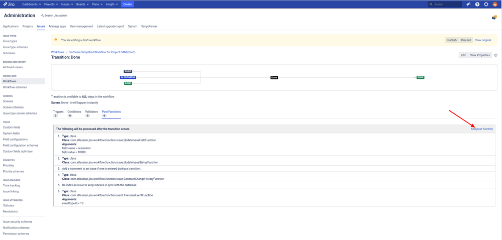

1. Go to the workflow of the project from which you want to trigger the change. In this example, the project that will trigger the transition is the Sample project. Once you are in the workflow, add a Post-Function as shown in the image below:-

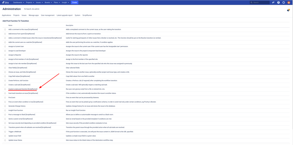

2. Next, select the Custom script post-function [ScriptRunner] option as shown below:-

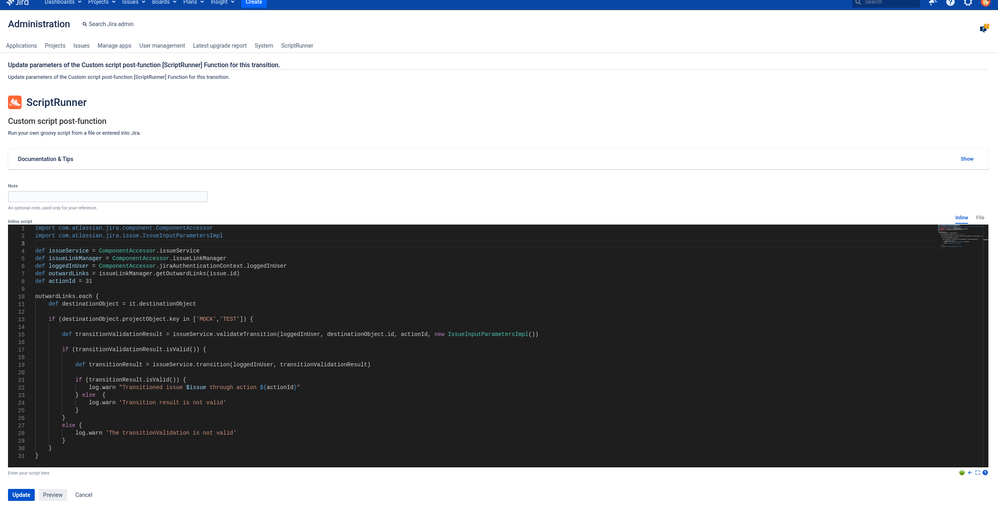

3. Once you are in the Custom script post-function [ScriptRunner] screen, add the code after you have modified it. Next, save the code and Publish the change made to the workflow.

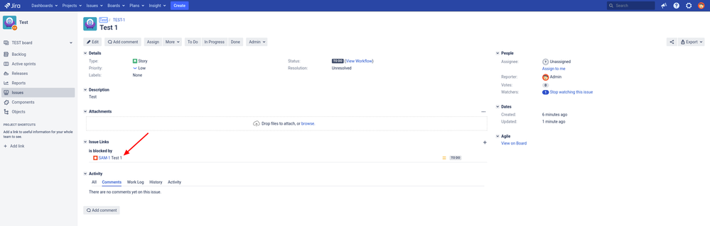

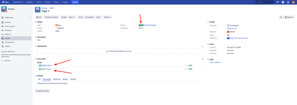

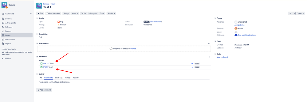

1. In this test case, 3 projects are used, i.e. Sample, Mock and Test. The issue in the Sample project blocks issues from both the Mock and Test projects, as shown in the image below.
Note: In your case, although you are using the created and created by issue links, it will work the same.

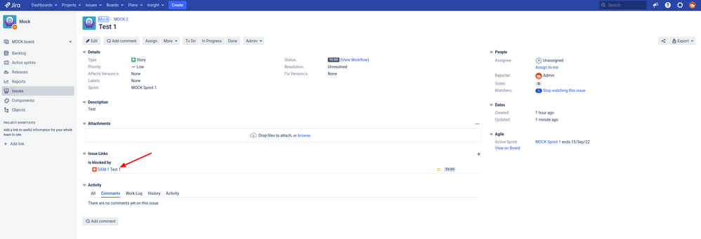

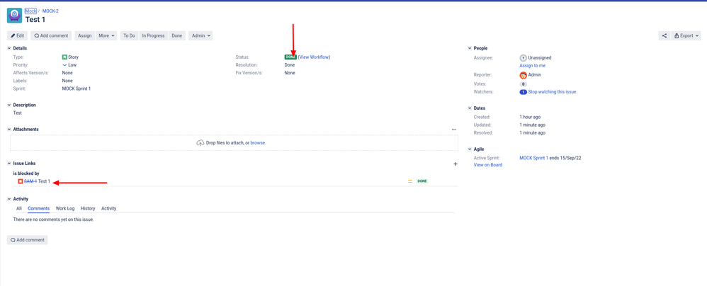

2. Similarly, the Issues from the Mock and Test project are blocked by the issue from the Sample project as shown in the images below.

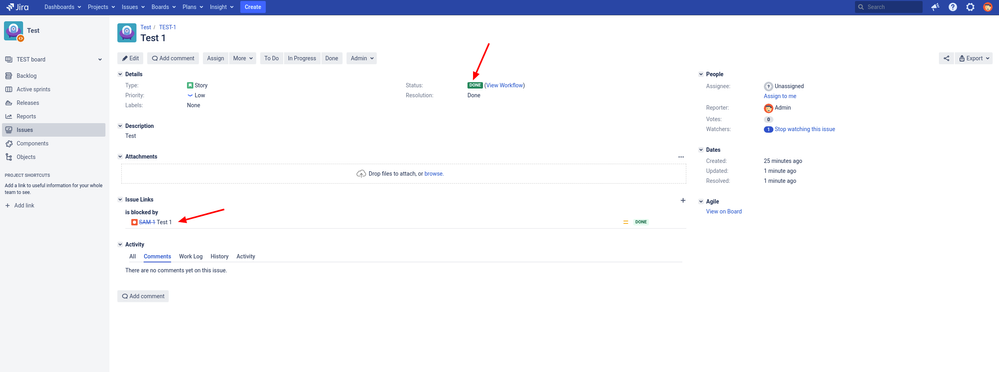

3. Next, the issue from the Sample project is going to be transitioned to Done, and as expected, the linked issues from the Mock and Test projects are transitioned to Done as shown in the images below:-
