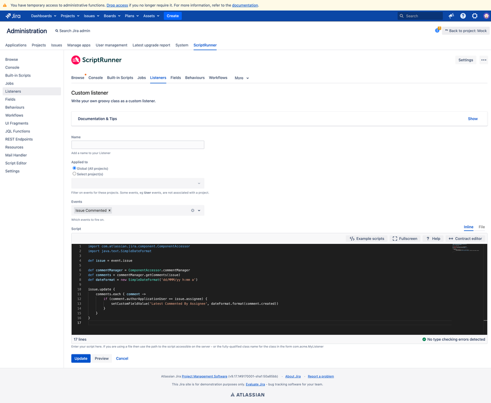

For your requirement, you must use ScriptRunner's Custom Listener along with the Issue Commented event.
Below is a sample working code for your reference:-

Please note that the sample working code above is not 100% exact to your environment. Hence, you must make the required modifications.
Below is a screenshot of the Listener configuration:-
What this code does is that it reads through all the comment histories of an issue and will only extract the latest comment that the assignee of the Issue has added. From there, it will update the Date Time file with the Date and Timestamp when the Issue was updated.
I hope this helps to solve your question. :-)

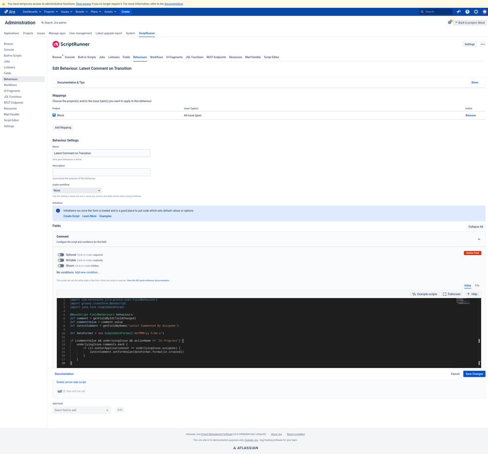

If you intend to update the Assignee Last Comment Date field when the issue is being transitioned, then in addition to the Listener code, you must include a Server-Side Behaviour code for the Comment field. This will update the Assign Last Comment Date field once the comment is added by the issue's assignee on the transition screen.
Below is a sample working Server-Side Behaviour code for the comment field:-
Below is a screenshot of the Server-Side Behaviour configuration for your reference:-
