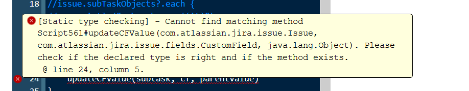

The code gives an error, updateCFValue() methof is not found Thanos, Can you please help me out with the error

Hi Thanos,
I would you like to use your script for update the Due Date field in Sub-Task if the Parent Due Date Field is Updated using a script listener, BUT your code gives the error below ...Error.png
Could you suggest me the correction with the modification for use the Due Date field?
