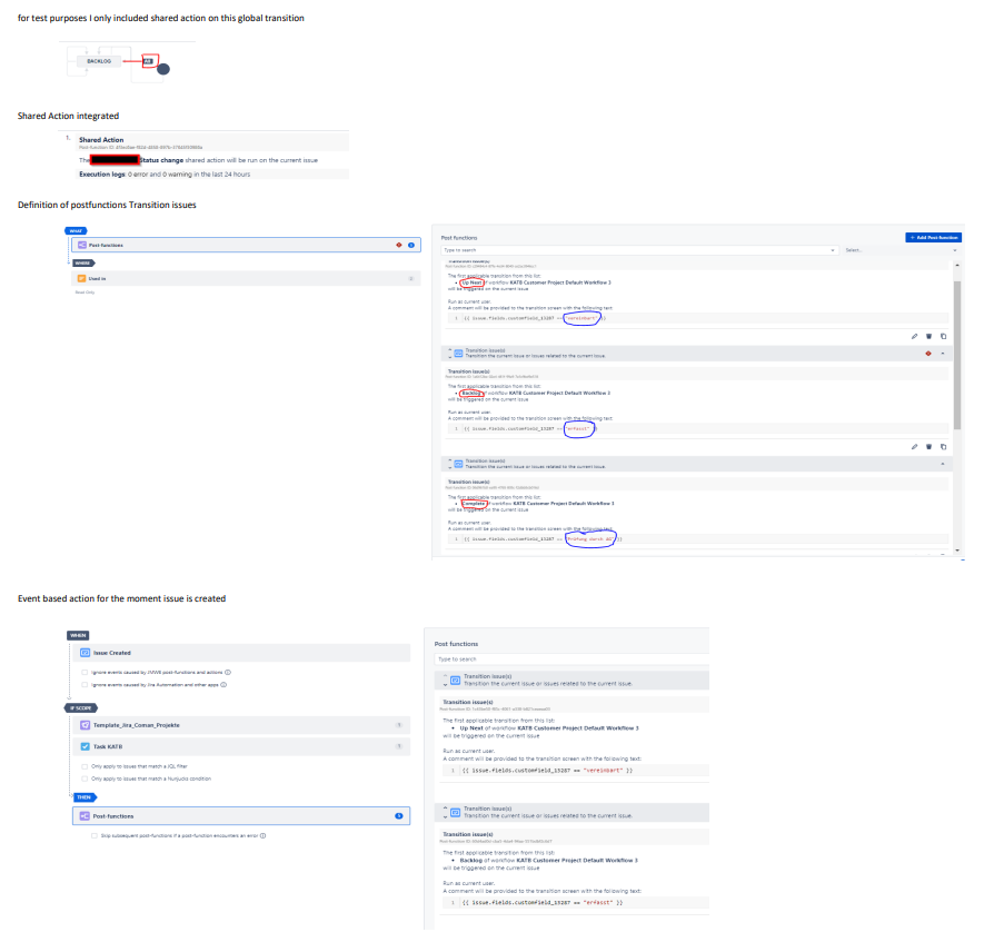

In the moment I create a new issue the following happens:
  • Custom field contains value 2, status B is expected after creation
  • What happens is that the newly created issue changes successively through all statuses (A, B and C) automatically
  • Concerning the event based action I wonder how I integrate it in the workflow
David Fischer
June 11, 2024
Hi @Anette Noll
from what I can see (your screenshot is not very legible), you didn't provide a "conditional execution" script but instead a comment text. You need to add what you put as comment text in the Conditional Execution option.

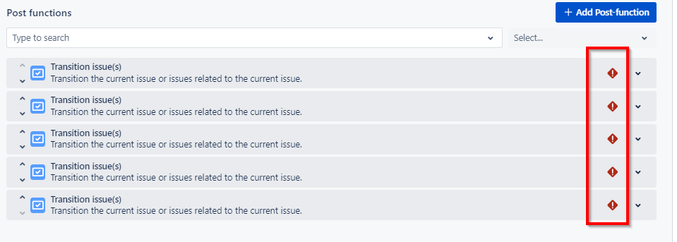

  • All postfunctions in the shared action show errors.
    I guess that this is because of this:
    if field value changes and issue has been refreshed, status plays kind of ping pong until finally the correct status is displayed. Any solution to this?

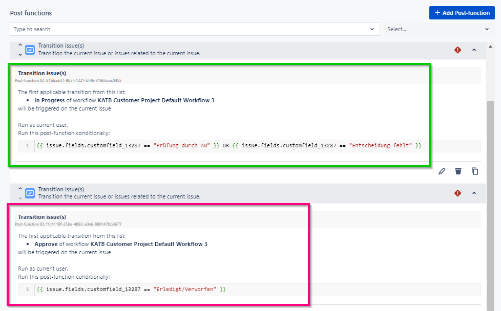

  • only one post function does not produce the expected Jira status.
    Expected status is Approved - issue refresh and the following happens:
    approved - in progress - approved - it stops and stays with "in progress"
    I cannot find any significant difference between postfunction that produces correct status (green frame) and postfunction that produces incorrect status (red frame). What am I overlooking?

Regarding the errors, you'd need to expand one of them to see the actual error details and share that here.
Regarding the status changing on the screen, it's a limitation of Jira Cloud, it updates the status "lazily".
As for the transition that fails, you need to check if it has a transition screen and a validator that prevents the transition from happening. You can try to manually trigger the Approve transition and you'll see if there's any requirement during that transition.
