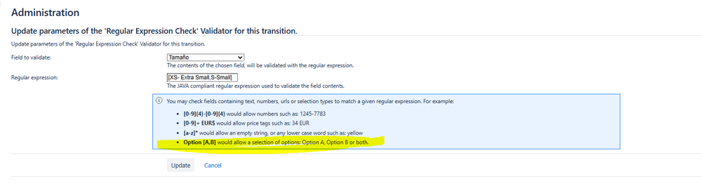

I've been working on a new workflow an I have built a transition that includes a validator for a regular expression check. I would like to allow a selection of options so I believe that the best choice is to use "Regular Expression Check" . I have tried what appears in the picture below but is not working, it gives me an error.
Can anyone help me with this? Am I using the right expression?
Thank you in advance!
Mario

@Mario Palacios Fernández  It's wrong mentioned on the page.
Regex would be : (Small|Large|Xtra Large)
Each value separated by pipe |
Eg : (Done|Not done)
April 7, 2025
Hi!
Now it works! thank you so much!
So it is wrong mentioned on the info panel on the page?
Mario
Like Vikrant Yadav likes this
Vikrant Yadav
April 7, 2025
Yep, on info panel it's wrong. comma (,) doesn't work as OR operator in Regex.
