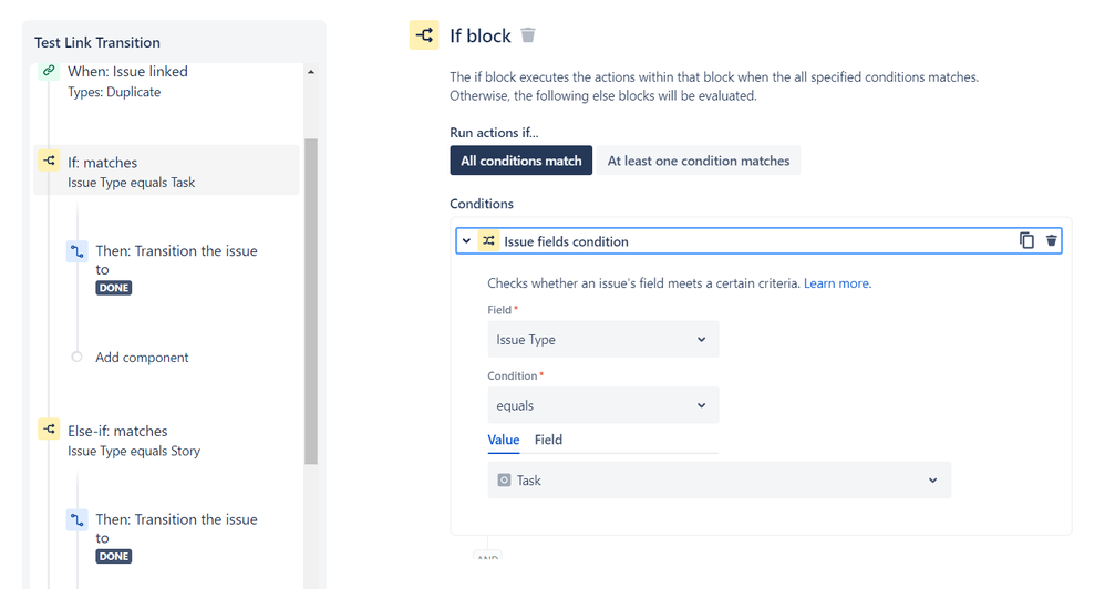

Hi Stuart,
You can try this Automation shown in the attachment.
Replace Issue Linked Type name , Status name and Issue Type name as per your requirement.
Stuart Barker
March 10, 2023
CAPS are for clarity only..... This doesn't quite work for me, let me be more explicit:
I have a linked type of "Requirement Tested", outward = "tests", inward = "is tested by".
I then have two issue types:
a requirement - can have a status of NOT COVERED, COVERED, TESTED
a test case - can have a status of PASS, FAIL, or NOT RUN
When I link a Requirement to a Test via "is tested by" I want the Requirements status to change to COVERED.
Similarly, if I link a Test Case to a Requirement by "tests" I would like the Requirements status to change to COVERED.
In pseudo code:
If issue linked THEN
  IF (issue type = requirement AND link type = "tested by") THEN
     SET current issue status = COVERED
  ELSE IF issue type = test case AND link type = "tests" THEN
     SET linked issue status = COVERED
  ENDIF
ENDIF
