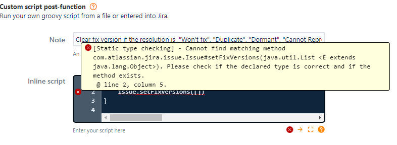

I tried
issue.setFixVersions([])
in our environment (Jira 8.8.1, SR6.0.1-p5) and get the following error:
Has there been a change in the API affecting how to clear FixVersions for an issue?

Jonas Frid
June 26, 2020
@Leo
Finally found that 6.0.1 suffered from:
SRJIRA-4308 - The type of issue in post-function was incorrectly Issue and not MutableIssue.
This was solved in 6.1.0.
(The code you suggested was my original code version where I discovered the error mesage ... so it was of course a good and valid suggestion ;-) )
