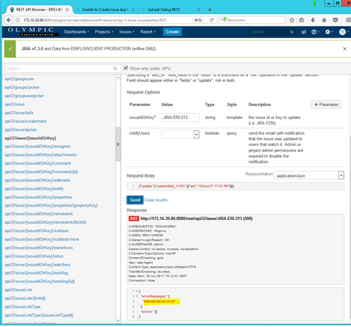

We try to update directly by Atlassian REST API Browser but we find the same resut that our jira service java code that's "500 Internal Server ERROR".
When we created the issue, there are not problems with these custom fields that are setted normally but the customfields are updated on production side end we need to update  in customer side but we found this problem. We've tried to send the request body "{"update":{"customfield_11381":[{"set":"19/Jun/17 17:01 PM"}]}}" or "{"fields":{"customfield_11381":"19/Jun/17 16:01 PM"}}" with the same result from customer server 500 Internal Error and log of customer side server is:

Caused by: java.lang.ClassCastException: java.sql.Timestamp cannot be cast to java.lang.String
 at com.atlassian.jira.issue.customfields.impl.rest.TextCustomFieldOperationsHandler.getInitialValue(TextCustomFieldOperationsHandler.java:43)

somebody has idea why this happens
Nic Brough -Adaptavist-
June 19, 2017
Towards the end of your error message, there's a line that says your field is failing.  You are giving it a date, but the field appears to be trying to convert that to a text format.  Or possibly the other way around, but either way, the code in your field does not know how to handle the incoming data.
