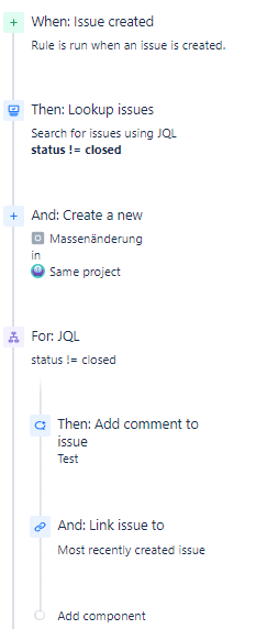

Hi,
I have following use case, which already works
When a new issue is created (Trigger)
look, if there are already existing issues with similar information based on JQL (Lookup)
Create a new ticket with some information of all found issues (Create new issue)
for every found ticket (JQL-Branch)
 - create a comment (Create a comment)
 - link it to new created ticket (Link issues)
Now my question:
Is it possible to use an advanced Branching instead of JQL-Branching to achieve the same outcome?
It is highly dissatisfying to use the same JQL two times instead of reusing the "code".
When I switch the branching type, the comments and links were added to the triggerissue, instead of the issues of the lookup result.
Do I have to access the lookup result in a special way other than "{{lookupIssues}}"?
just for info: I simplified my usecase. The JQL is more complex in reality and I need the lookup result also in some if conditions.

Hi @Jan-Hendrik Wolf and welcome to the community!
Unfortunately, this is not possible.  There's a request with only a few votes to allow branching against Lookup Issues results here:
https://jira.atlassian.com/browse/AUTO-461
So, you're doing things the right way given the constraints.

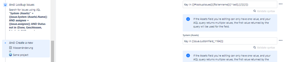

As mentioned, I simplified the automation in my comment. The real query in the lookup is:
"System (Assets)" = {{issue.System (Assets).Name}} AND assignee = {{issue.assignee}} AND Status not in (Done, Geschlossen, Erledigt) AND reporter = {{issue.reporter}} AND issuetype != Massenänderung
Now I am accessing the field "Rollenname" in every found issue to populate a multivalue asset field while creating a new ticket.
Key in ({{#lookupIssues}}{{Rollenname}}{{^last}},{{/}}{{/}})
After creating this new issue, I want to update the found issues in the lookup. To iterate over them, I am using the same query.
While I was writing this, Mark already crushed my dreams for a perfect solution as https://jira.atlassian.com/browse/AUTO-461 describes my problem perfectly.
