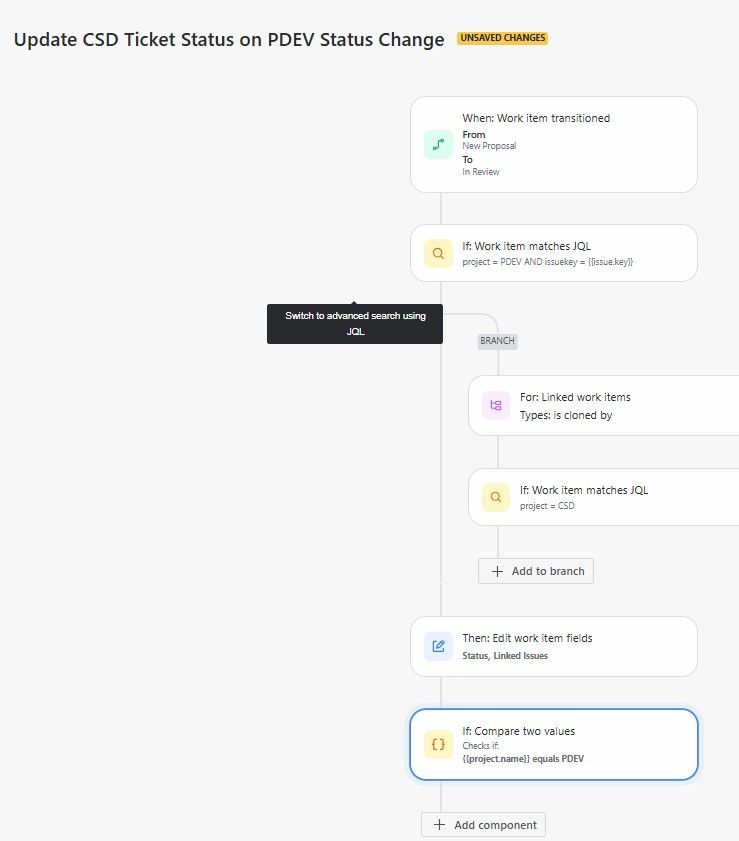

Hello,
Yes we are company managed and when we create a CSD ticket that goes to PDEV that ticket automatically links to CSD. I do have access to create automation in CSD but I don't have access to PDEV.
What would need to be done in PDEV? I started building this out but when I validate the PDEV tickets for my JQL query it returns 0. My CSD query returns the number of total tickets as expected. Not sure what I'm doing wrong or what next steps would be.
Screenshot 2025-05-22 094936.jpgThank you,
Laraine

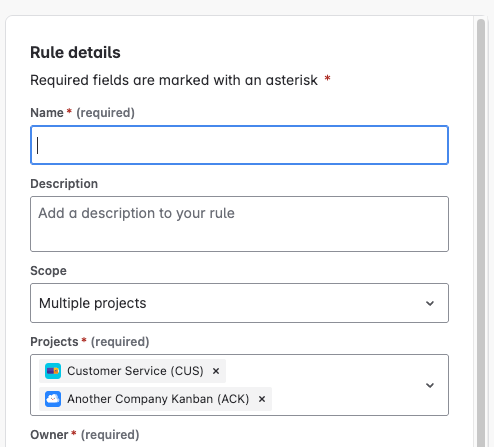

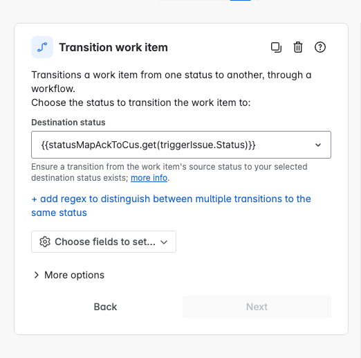

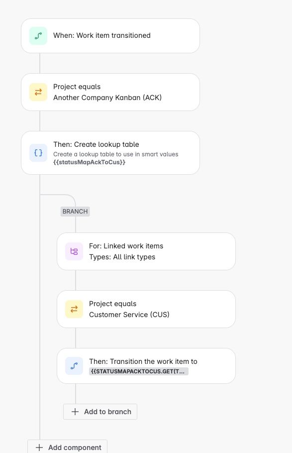

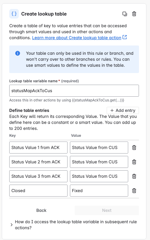

Trudy P Claspill
May 22, 2025
Here's a quick rundown in images. If more details are needed, I suggest that you tell your admins to join the Community and participate in this Question so that the conversations don't have to go through you.
Rule Details where the scope is set to both projects
Rule
Details of Lookup Table step
Details of transition step

Okay,
This is great! I really appreciate your time. Just one more question. We did go in and add a workflow in CSD that replicates the statuses that go through DEV and renamed them for customer facing statuses.
So would we need a lookup table if the status fields for PDEV are already in CSD?
Thank you

Laraine Porrazzo
May 22, 2025
@Trudy P Claspill
We were able to figure it out using some of your suggestions above. We didn't need to use the lookup table. Thank you so much for your time and help.
