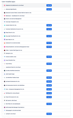

Hi all,
Do any of you have the same experience as I have I suddenly see the Free Trail button on all app that are free up to 10 users.
I have my own free Jira Cloud subscription, I have no more then 10 users or 3 agents licensed.

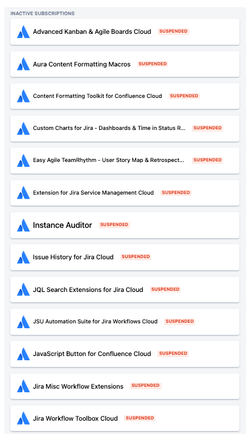

If I look into the Managed subscription section I see most apps as suspended, do any of you have the same experience?

Hi all,
I did notice that on all the apps the Entitlement ID is missing or removed.
If I uninstall an app, I can also not install it again.
