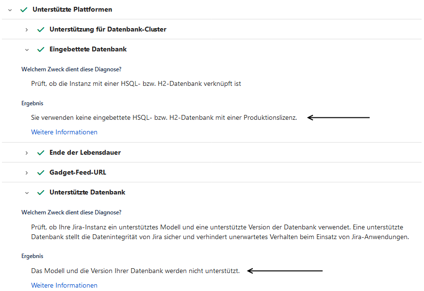

Dmitri
October 23, 2020
Hi Andy,
thank you for your detailed response.
For all the upgrades from the older Jira versions the embedded database has been used. I only installed PostgreSQL for the first time with Jira 8.13, so that's probably not the reason.
Actually there isn't even a warning as such. Just the result of the health check looks "irritating", because it says that the embedded database is not being used, while it also says that the model and version of my database are not supported.
The attached screenshot is in german, but shows what I mean, I think:
I didn't notice any errors so far, just wasn't sure if I could ignore this or if something might still be wrong.

Daniel Ebers
October 26, 2020
Hi Dmitri,
is the error message the same when switching to English language?
It would be somewhat funny if only the sentence would have been put into language file with a translation error in it ("werden nicht unterstützt" instead of "wird unterstützt").
Cheers,
Daniel
Like • Dmitri likes this
Dmitri
October 26, 2020
Hi Daniel,
you are right, it seems to be just a translation error. After switching to English, the sentence is "Your database model and version are supported."
"Problem" solved then, thanks all and sorry, should have tried that myself first...
Best regards,
Dmitri
Andy Heinzer
October 26, 2020
Very strange, that screenshot showing the green check indicates everything looks good here.  Granted I do not recommend doing an upgrade to Jira's data using the H2 SQL database, as technically that is not a supported platform for upgrades (only evaluations).  But thanks for the help here @Daniel Ebers !!! My German is pretty poor so I appreciate the additional translation here.
I'll look into creating a translation bug for this one.
Andy Heinzer
October 26, 2020
Did some digging, found that Atlassian already had an internal ticket about this problem created.  However the public facing ticket on JAC of JRASERVER-69685 was technically created in the wrong project for this support tools plugin.
So I created an appropriate clone of this over in ATST-1026.
Sorry for the mix up of translations here.
Andy
