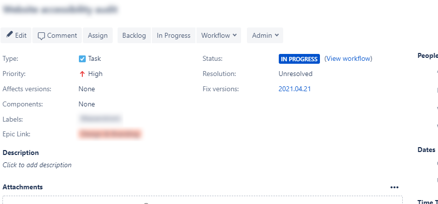

I have a task that was released by accident and I can't find any way to dig it out of that fix version and bring it back into my Kanban board. Is there any way to do this? I'd rather not create a new task since I'm trying to not have duplicates.

I don't appear to have the ability to remove the release from the Fix Versions field. It's just a clickable link to the full release but I don't have an edit icon to remove it. I'm an admin, so I'm not sure why I wouldn't have permissions, either.

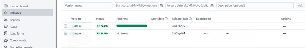

Alagu Murugan Krishnan
May 21, 2025
Click on Releases on Left hand side Menu Bar, and you will see the respective releases.
Click on the Action (three dots) and Unrelease it.
