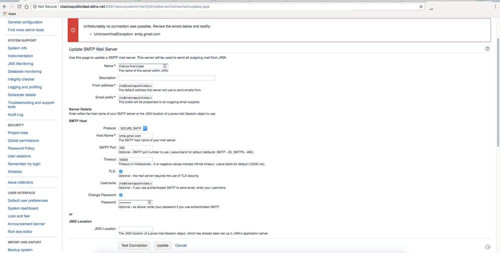

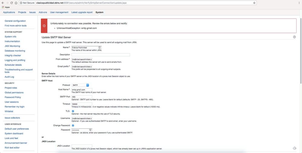

Hi please you can help me to configuration of my email account in my jira server 7.70 thank you
Error show me
Unfortunately no connection was possible. Review the errors below and rectify:
  • UnknownHostException: smtp.gmail.com

Harold G
January 30, 2018
Hi Shannon I doit all this recomendation but I have the same problem please you can help me with another recomendation thank you for help me
