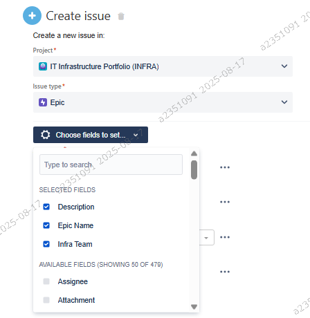

I'm trying to setup an automation for creating an Epic from another Project.
But I'm facing this issue.
Even though all fields are already on creation screen and actor for the rule is also set with the required permissions but still facing this issue,
3 answers
Trudy P Claspill
August 17, 2025
Hello @Muhammad Wahaj

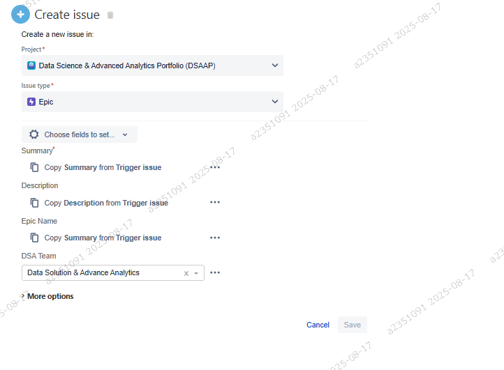

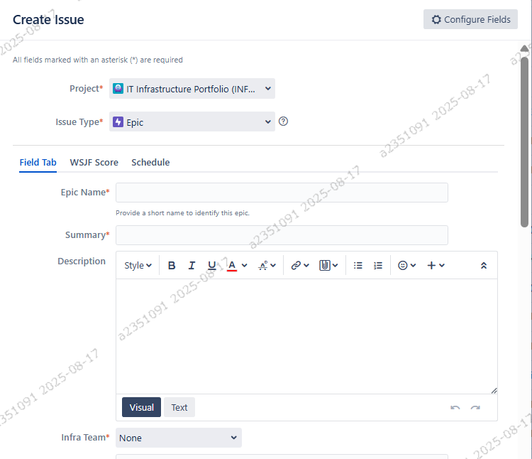

I noticed that in your images from your rule the Project you are specifying for the Epic creation is not the same as the Project that you are showing in the Creat Issue dialog screen images.
Can you share an image of the Create Issue dialog for an Epic in the same project you are targeting in your rule?

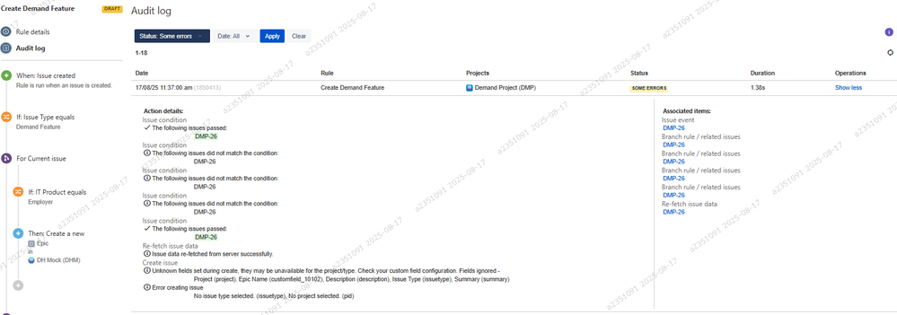

Trudy P Claspill
August 17, 2025
Can you provide screen images that show your entire rule, please?
The portion of the rule you have shared shows only a Create Issue action to create an Epic in the DHM project.
But the Create Issue Action details you shared and the Create Issue dialog you are sharing is for the project DSAAP.
Additionally the messages in the rule execution Audit Log are indicative of some other portion of the rule being executed, rather than the portion of the rule you have shared.
There may be something relevant to the problem in the portions of the rule you have not yet shared.

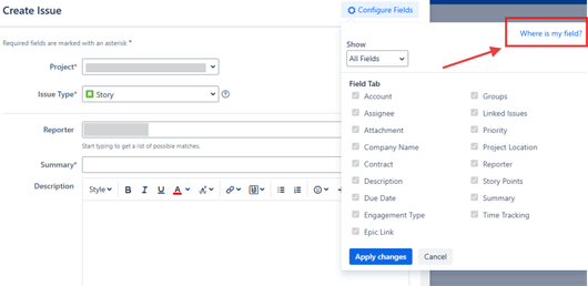

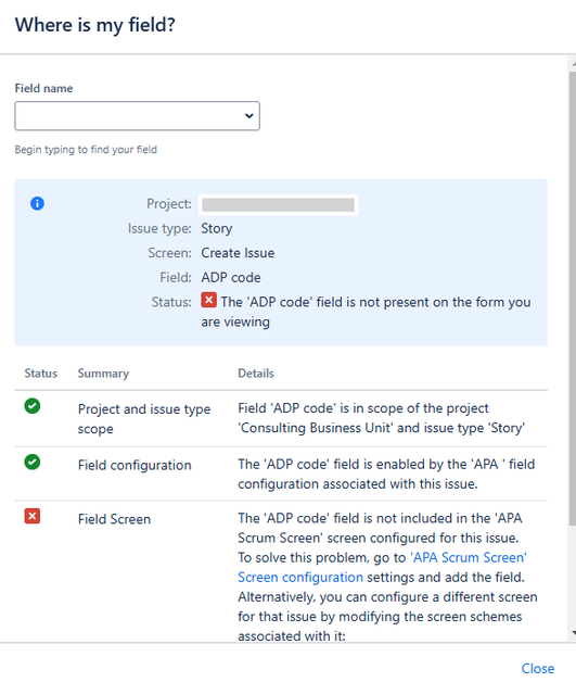

Hello, @Muhammad Wahaj ! Welcome to the Atlassian Community!
From the error message, it seems there might be an issue with the fields. When you use the "Where is my field?" feature to search for the desired fields, does is it say that all fields were found? I believe this could be a good starting point to investigate the problem.
Here is a official Atlassian document with some additional suggestions to troubleshoot:  Fields missing on screens in Jira Data Center
Let us know if it helps :)
Regards,
Izabela
Muhammad Wahaj
August 17, 2025
Hi thanks for the reply Izabela,
but the relevant fields are already on the screen.
