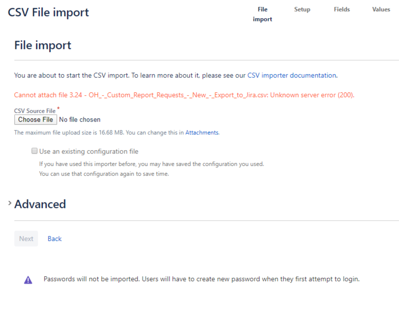

Multiple people on my team are trying to import issues in different projects using the External System Import feature and are getting the error:
Unknown Server Error 200.pngThe functionality was working last week just fine, but we have not been able to use it this week.

Hi @Benjamin Kister
I know it's been a long while, but for the sake of all people that find this question in the future, here is a diagnosis of mine for this problem:
Looking at the HTTP request sent by the browser to upload the file, which uses the endpoint "/rest/jira-importers-plugin/1.0/AttachTemporaryFile", I noticed the HTTP response was coming as a 200, when in fact, it should be a 201, because an upload was made, and that's how our server responds to it.
That was intriguing, why was our server answering the same procedure in different ways? So I looked up our own backend logs, and absolutely nothing was there for this call, we did not answer this.
Back to the HTTP request's response, the remote IP address was a 10.x.x.x, this is reserved for private networks, which means the answer came from the same local network. Now scroll down to the HTTP response headers and voilá, a host name, and none of our Atlassian headers, the actor was a middleware that scans requests before sending to the internet (to our server).
It turns out this middleware blocked the request, but answered to the end user's browser as a 200, as if nothing wrong happened, breaking the CSV upload experience, because it actually never happened.
