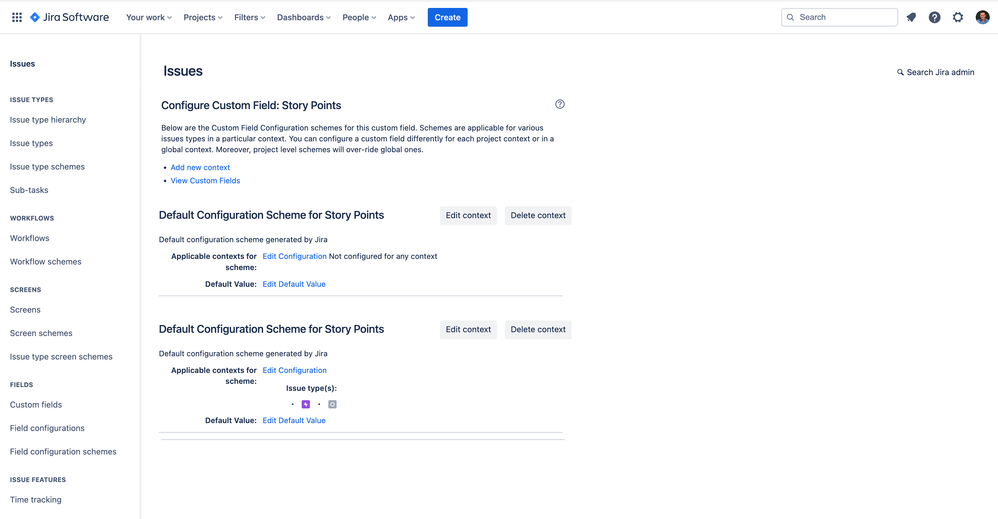

Junior Atemebang Ashu
February 18, 2025
Following the previous steps until this point: https://community.atlassian.com/t5/Jira-questions/Re-Re-Unexpected-failure-occured-when-creating-a-Kanban/qaq-p/2289439/comment-id/569521#M569521
  • Delete the first `Default Configuration Scheme for Story Points` where you see `Edit configuration Not configured for any context`.
  • Try creating the board or project again with a different name if a backup or previous version is still available in the system.

Andre Fortier
March 5, 2023
Thanks.
I followed the steps.  I don't see my projects listed.  I see two fairly similar sections so I don't know if any of these are the issue.
here's a screenshot of what I see:
Bill Sheboy
March 5, 2023
That defect I referenced was when the Story Points field had the problem and that does not appear to be the case for this one.
As it could be another field, you may need to wait to hear back from Alex contacting the Atlassian team.

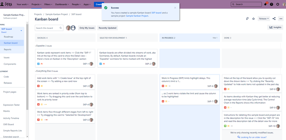

Alex Koxaras -Relational-
March 5, 2023
Hi @Andre Fortier
On my instance, creating a sample kanban board works as expected:
In addition, I don't see any incidents on https://jira-software.status.atlassian.com. At least not yet.
