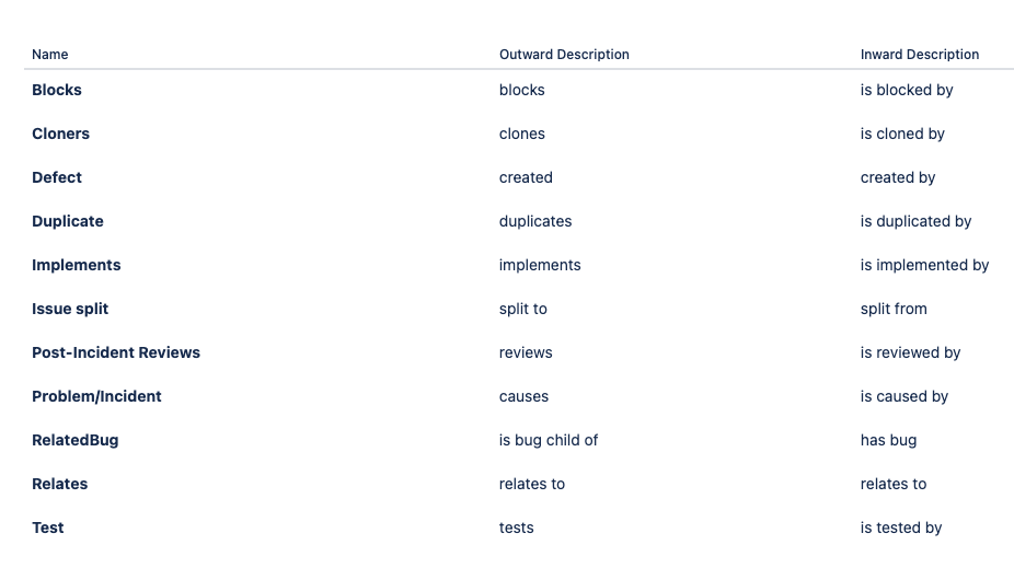

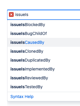

The options you see in JQL will depend on the Link Types that have been defined for your Jira instance. Here are examples from mine:
Screenshot 2024-08-19 at 10.10.47 PM.pngScreenshot 2024-08-19 at 10.10.17 PM.png
The options will match to the Inward and Outward Descriptions of your link types.
