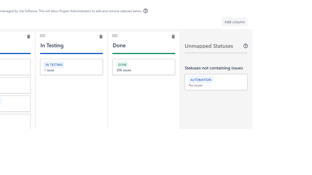

Just to verify the status ' tech' is located in the column 'tech' ? I added an example of an unmapped status

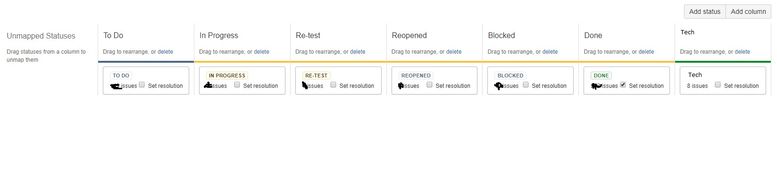

Sagar Yadav
August 29, 2018
JiraStatus.jpgHere are my columns and status. There is nothing unmapped.
Quick filter that fails to return any results is - status = Tech
Search query that returns results is - project = ABC and issuetype = Story and status = Tech
Also, I have noticed that bugs with status Tech are returned when quick filters is selected, but no user stories with status tech are returned.
