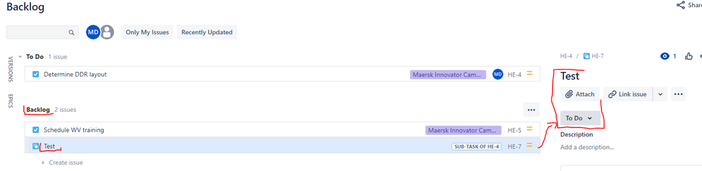

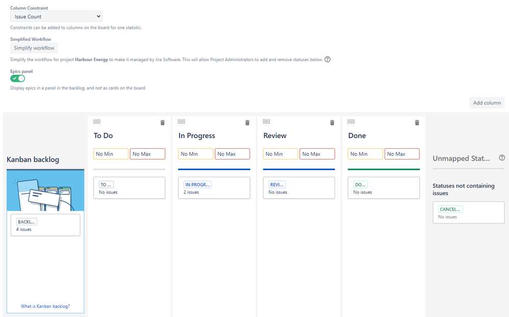

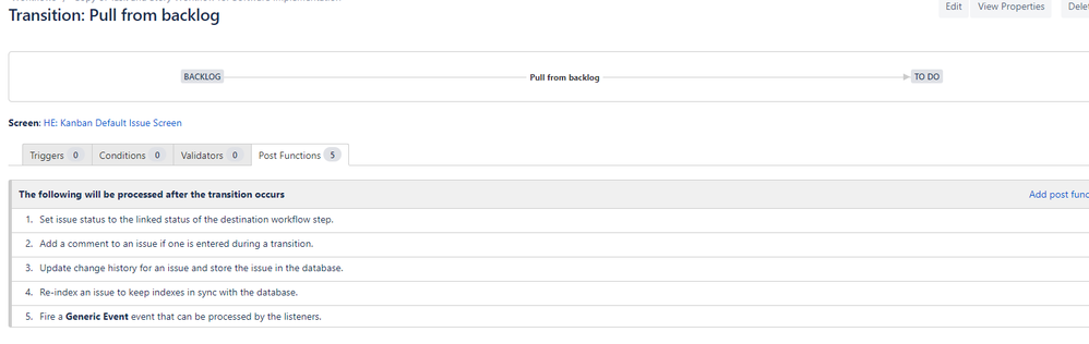

I have a built a workflow with transitions and mapped statuses from the workflow to the Kanban board, but I am not able to transition an issue with a sub-task from 'Backlog' to 'To Do'. However, I am able to transition them individually.
I believe I should be able to do so as described here unless I did something wrong in the workflow/transitions setup? Or it is only available for the premium plan?
Any help would be much appreciated.
Here are screenshots of the setup

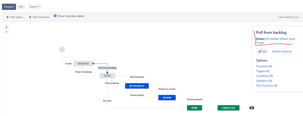

Do you have a transition screen on the transition from Backlog to To Do in your workflow?
Deleted user
September 22, 2021
I do have the default Kanban issue screen selected for all transitions including from Backlog to To Do.

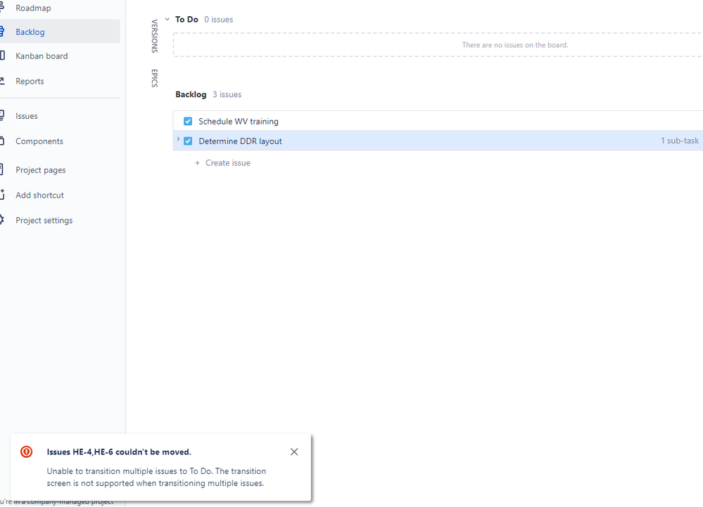

That's the problem, I think. The multiple issues will not transition when there is a transition screen attached. If you removed the transition screen as a test, it would probably work to just move the collapsed parent issue.
Deleted user
September 23, 2021
John,
Yes, it works without the transition screen but then you kind of make the workflow irrelevant if 'All' can transition to 'To do' and/or 'Backlog', right?

Depends on what your transition screen is doing and why you have to have it.

Yes, when I move the task from 'Backlog' to 'To Do' it is in a collapsed view (see below). When I expand the task I can move the task and sub-task individually from 'Backlog' to 'To do'. I just realise I didn't attach the error I get. Here it is:

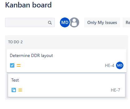

I am not sure how one can collapse the task on the kanban board? I see this:

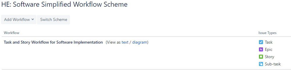

All my issues (epic, story, task and sub-task) share the same workflow
