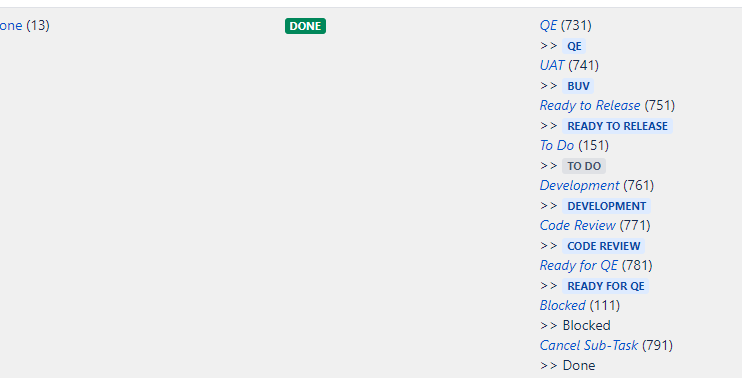

Thanks for the response. I do believe I have the correct id, here is where I found it
David Whitlock
February 23, 2023
I realized I was referencing the wrong workflow. Once I add the correct id, I no longer got this error.
