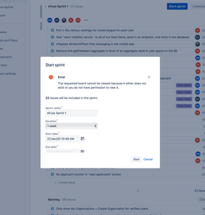

Issue:
When attempting to create a sprint, I see this error message: "The requested board cannot be viewed because it either does not exist or you do not have permission to view it."
After reviewing similar issues online, I am unable to resolve this permissions issue.

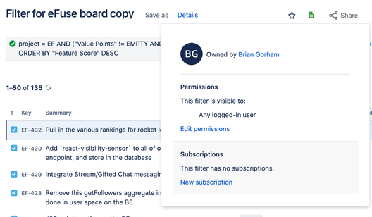

  1. I am using a custom filter on the board and have confirmed that I own the filter and have permission to it.

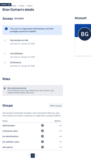

  2. I have every admin group possible assigned to my user.

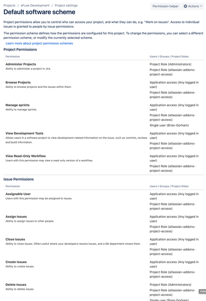

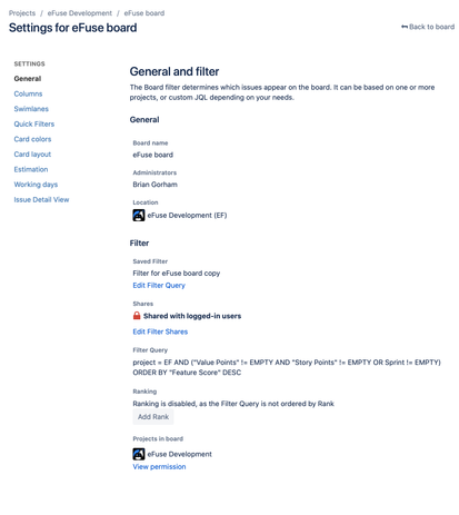

More screenshots:
Screen Shot 2020-01-27 at 11.18.46 AM.pngScreen Shot 2020-01-27 at 11.18.21 AM.pngScreen Shot 2020-01-27 at 11.17.50 AM.pngScreen Shot 2020-01-27 at 11.17.39 AM.pngScreen Shot 2020-01-27 at 11.16.26 AM.png

Does your board filter include more than one project? If so, you need to have all of the correct permissions for all projects included in the filter.

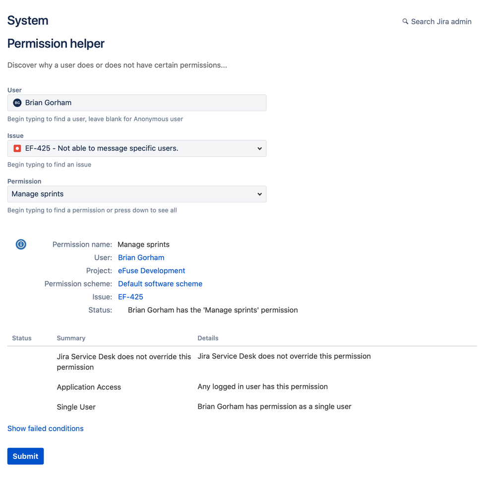

Next thing to check is the Permission Helper to see what it says.

I believe I only have one project now, so the filter is only linked to that one project. I have attached some more screenshots to the original post above, if that helps.

How about the Permission Helper?
Looks like you have everything right. Since it went through so many other hoops with the move and imported issues, I would go ahead and put in support ticket with Atlassian.

Here is the permission helper

Are you also the Administrator of the board?
Ravi
Brian Gorham
January 27, 2020
yes, I am
