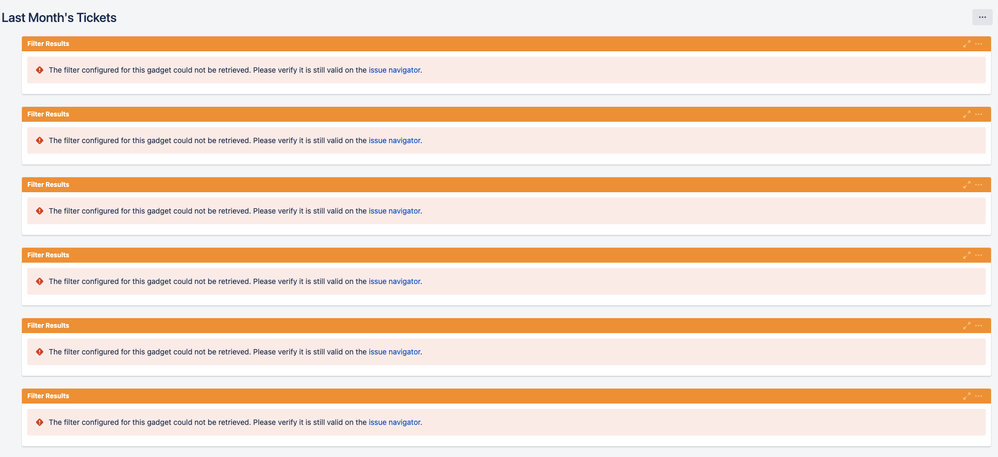

I have created a dashboard, with gadgets displaying filtered search results from a certain project.
I have created a group, added the user to that group, given that group View permissions on the dashboard, given that group View permissions for those filters, and that group has Browse permissions for the project that the filters are querying - and yet the user can not see the contents of the gadgets within that dashboard (but can access the dashboard itself).
Any idea what I'm doing wrong? Any help would be really appreciated!

Can you please share a screenshot of the dashboard from the user side?
It may help to identify the error.
Thanks,
Anvesh
James Burdett
July 28, 2021

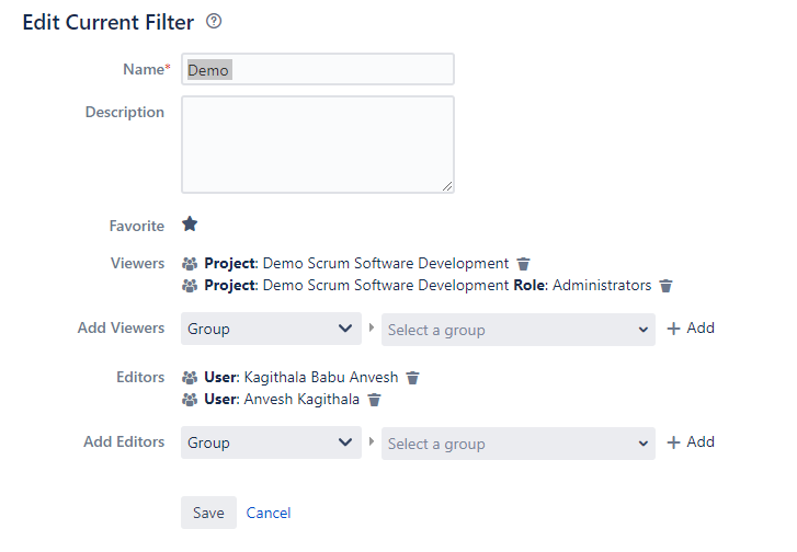

Please check the JQL Filter permissions.
I think he doesn't have view access to these results of this filter.
Giving View permission is not possible for Single users in Jira, I'm using the latest version of Jira.
You can able to give edit permission to a single user to the Jira filter.
Please check the above screenshot of my demo filter.
Check the "Viewers" section.
Thanks.

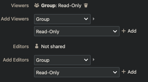

So here's what the dashboard permissions look like:
And here's what the filter permissions look like (they're the same for every filter):
Is it possible to give these permissions to a single group like this?

You can able to setup view access to --> Groups and Project Roles.
James Burdett
July 28, 2021
That's what I'm confused about, because it's exactly what I've done, but it's not working...
