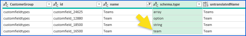

From what I can tell - you are correct that the "Team" field is a special type.  Its not a string or an ID ... its a Team
What I don't know is whether that means its what the REST Documentation is calling a "plan only team" (though I suspect it is).

About the field ID: I confirmed that customfield_10107 is the correct ID for the Team field by querying this endpoint:
GET https://----/rest/api/2/field/
The response included this:
"id": "customfield_10107",
"name": "Team",
"custom": true,
"orderable": true,
"navigable": true,
"searchable": true,
"clauseNames": ["cf[10107]", "Team"],
"schema": {
"type": "any",
"custom": "com.atlassian.teams:rm-teams-custom-field-team",
"customId": 10107
So yes, customfield_10107 is definitely the Team field.

The "schema" for the Team field is:
"schema": {
"type": "any",
"customId": 10107
The prefix com.atlassian.teams indicates that this is not a regular Jira field, but a special field managed by the Teams/Advanced Roadmaps module. This suggests that the field could correspond to either a Shared Team or a plan-only Team, and Jira expects it to follow the internal format used by Advanced Roadmaps rather than a simple ID or string.
However, I do not know how to confirm this for sure. Would you know how I can verify this to be certain?
