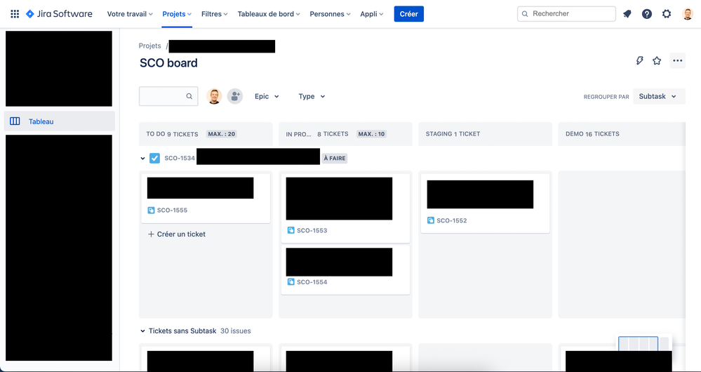

On the new Jira I have a Kanban board with tickets.
The tickets have assignees in the assignees fields - but I can't see them from the board. On this board I also appear as the only contributor on the right of the search field.

GroupBy Assignee results with a single line "Unassigned" (Non assigné) despite of having assignees on these tickets
When listing the tickets, all of them are set to No Assignees.

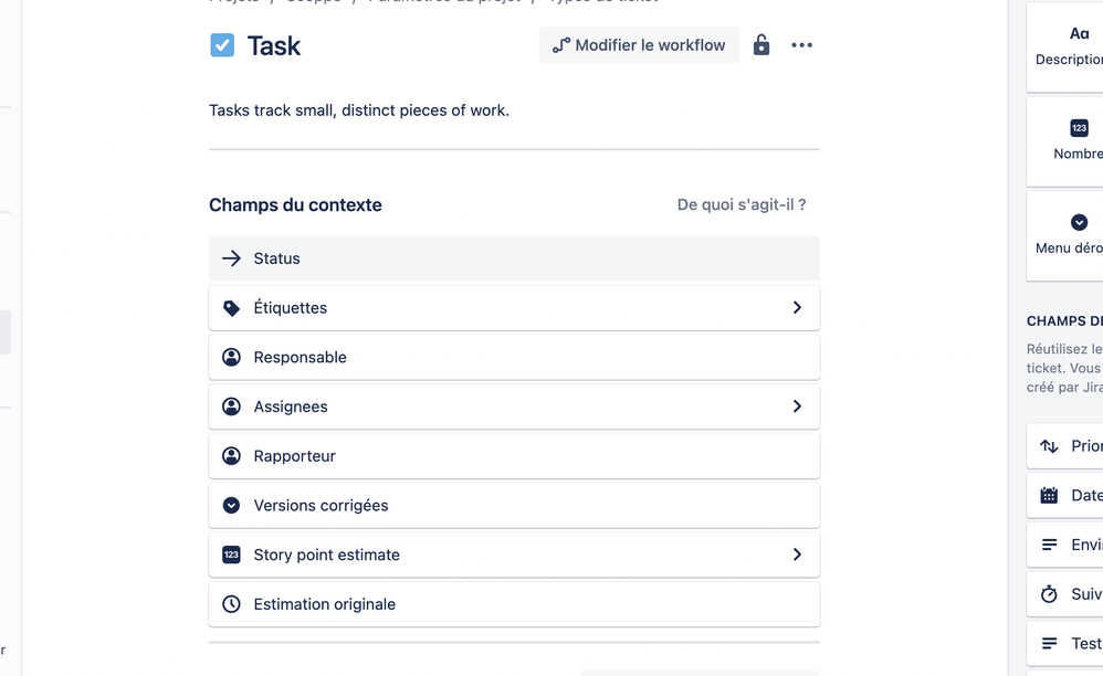

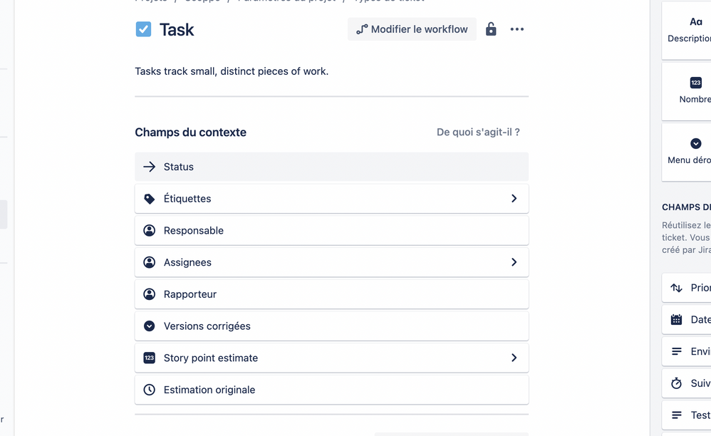

I recently switched back to a French computer, and there is something really weird: in the tickets details - all the fields are translated to french excepted the Assignee one (should be "Responsable", but it still be Assignee). I suspect a misconfig in my fields.

Ok, for some unknown reason I had a manually created field called "Assignee" which wasn't the system one.
I played with the workflows a while ago - to affect the ticket to someone when moved from "TODO" to "IN PROGRESS". This is probably where this duplicated field was created.

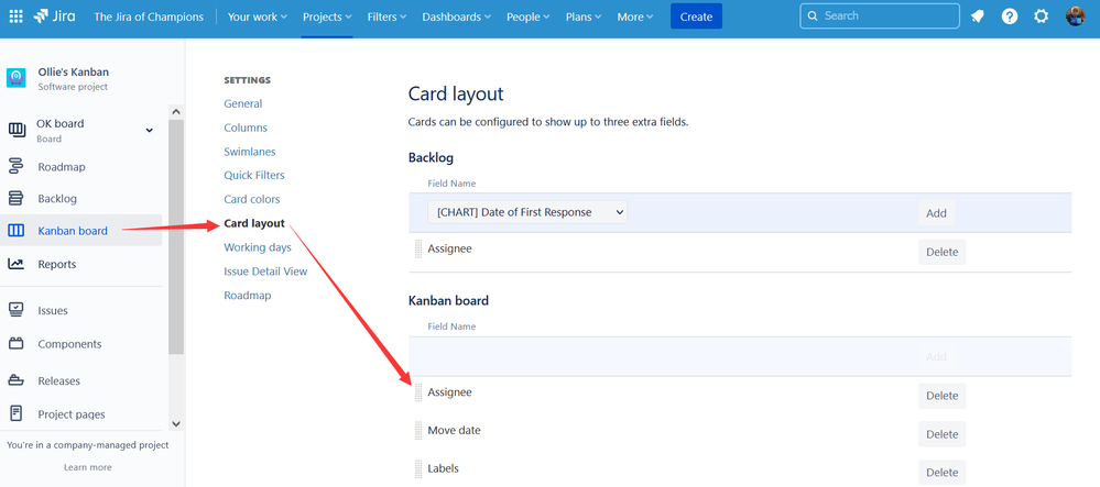

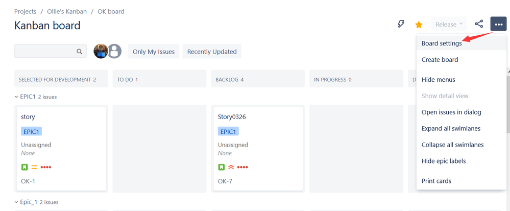

Go to more (...) -> Board settings and click Card layout.
https://support.atlassian.com/jira-software-cloud/docs/customize-cards/
