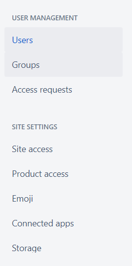

3) Went to User Settings > Management > but unable to see "User Directory" option ( screenshot above )
I am the admin of JIRA ( highest access ) but can't see User directory option as well.

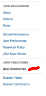

But since you clarified it will not be visible on cloud version, as it is visible on server/ DC version ( screenshot below from google ) jira_issue3.PNG
I want to integrate AD with my JIRA cloud.
Can you please assist next action items, thanks for your help in advance.
