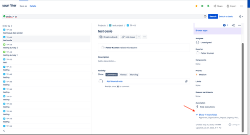

As you can see in the bug description, some users using the Chrome browser can not scroll down the left list of the issue navigator page. Can you take a look at the screenshot below and confirm if that's the behavior you are facing?
If that's the case, please vote and watch the bug to increase its priority and also receive notifications about its fix implementation.

Unfortunately, I was not able to reproduce your problem or find any existing bugs about it, so I'm afraid you might be facing a problem in your browser or even a new bug. In fact, if I move the mouse to the most left column where the list of fields is displayed, I can scroll-down using the own scroll-button of the mouse and the scroll bar appears at the right side of the list:
