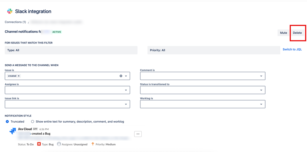

Could you please confirm on the project board if you able to see the tab slack integration and then try to delete the channel from there

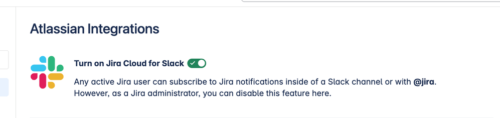

Please also check if the add on integration is enabled
Link : https://xxxx.atlassian.net/plugins/servlet/ac/jira-slack-integration/addon-config-page
so that you can enable the same and then see if the app is reflecting in your project

@Prachi Bolar Hi Prachi,
Slack Integration was not showing on the projects board. I then had a look at the + symbol and I then could see that I could add that.
I added that and now I can see the slack integration and can delete the linked channel.
Confirmed also in the slack channel!!!
So thank you - this worked great.
