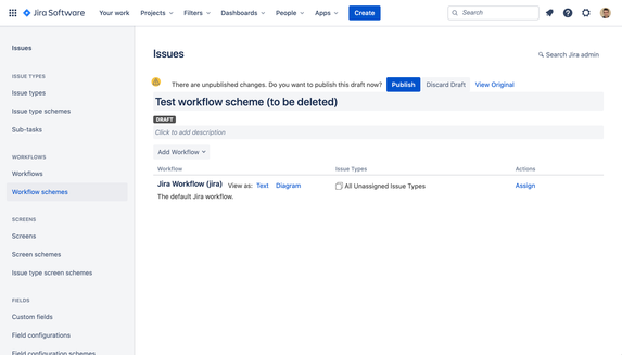

We have changed the workflows within a scheme but we are unable to publish the changes. The process ends with no error message. It certainly looks like a bug.
Here are our draft workflow scheme:

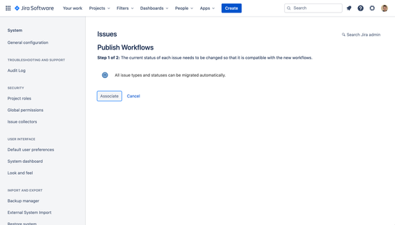

When I hit the "Publish" button I get this screen:

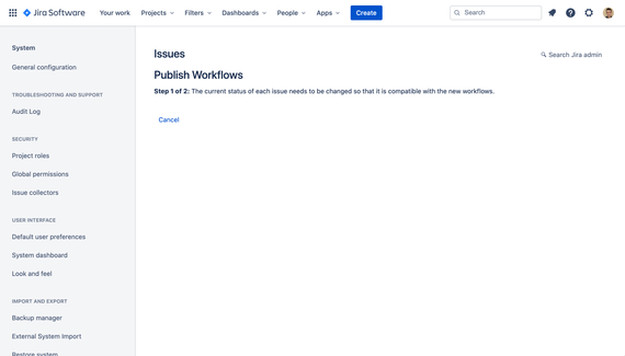

When I hit the "Associate" button I get this screen:
And this screen never changes. The process doesn't start no matter how long I wait. Hitting the "Cancel" button throws an ugly error message about "XSRF".

FYI, we just discovered that the scheme was used by a project that was in the Trash and that was causing the problem. Once we removed it from the Trash we were able to complete the wizard.
