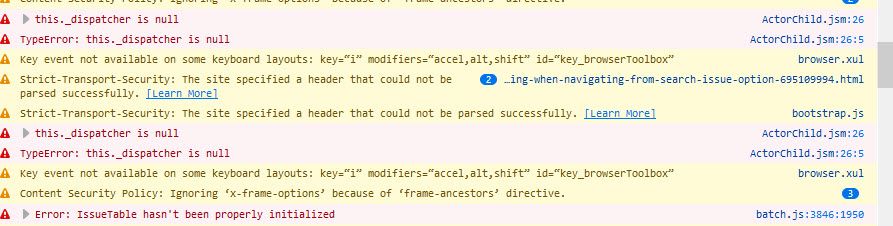

issues drop down.jpg With the below Java Script error.

@Tuncay Senturk _Snapbytes_Thanks for your reply. This is what i see
January 16, 2019
We're getting closer.
These javascript errors might be related with an app which may not be supported by your Jira. Anyway, you can try disabling apps one by one to locate the problematic app.

This is what I'm seeing in chrome. Enabled safe mode on plugins still no luck.
