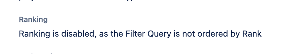

Hi @John Funk  - Question:  I'm having a similar problem here and since we moved to new JIRA Cloud, only some of my "issue" types in my project has the ability to move ranking and some issues have been disabled. I can't seem to edit the ranking in the board settings. Is there a way to enable this or do I have to re-create all the kanban boards?Screenshot 2023-06-06 at 5.50.36 PM.png

Hi Jayce - Welcome to the Atlassian Community!
That's probably because your board filter does not have ORDER BY Rank on the end of the query. So edit your filter, add that on the end and save it. Then you should be able to rank the issues on the board.
