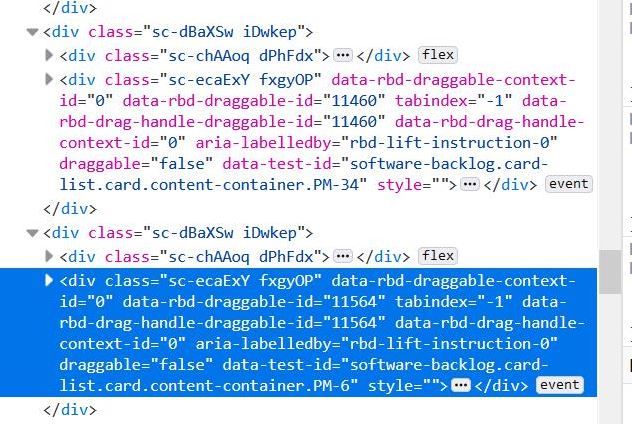

Within the backlog I cannot do a drag and drop of the issues. It shows that I am moving the task in the backlog but once I drop it the task goes back to its original position. I have looked into Permissions Scheme -> Issue permissions and 'any logged in user' has access to all listed permissions.
Looking through the html code and found that there is a option for 'draggable' however draggable="false".
