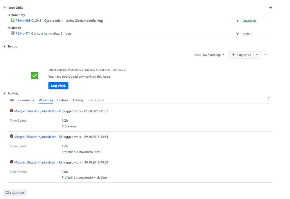

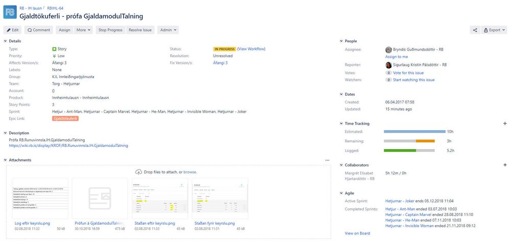

I have one jira issue (story) that we are unable to log work on now. There has been some work logged on this issue before, and no problem, but now we cannot log any work on it.
This issue was originally created 06.04.2017 and is used in a sprint. work has been logged on it 01.08.2018,  29.10.2018 and 30.10.2018
The issue is currently in a sprint, and has been in various sprints before. I am not seeing what could possibly be wrong.
Three days ago a Tecnical Task was linked to the story issue. I have removed the link, but that did not make a difference.
I have also tried cloning the issue to see if I could log work on the cloned issue (becaus I found this: https://community.atlassian.com/t5/Jira-Software-questions/Cannot-Log-Work-on-Issues-in-Sprint/qaq-p/619117 ) but that did not work either.
Will be attaching screenshots.

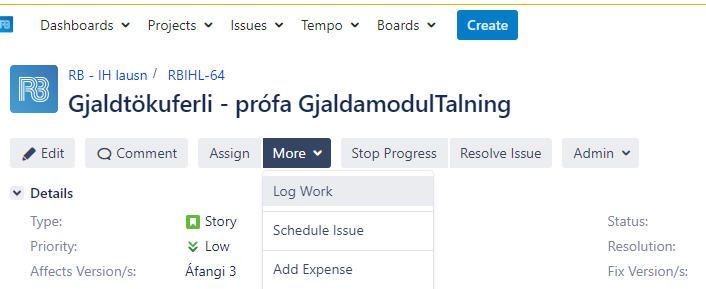

Hello,
You do not have the Log Work menu option?

Hi Alexey.

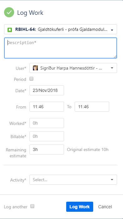

Are you talking about this?
Yes we do, but as soon as we have filled this out, and click "Log work" Jira just says "Error! Something went wrong"Error01.jpg
Alexey Matveev
November 23, 2018
I see. It is not a permission issue. You should look in the altassian-jira.log file.

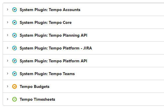

Hi Do you have any time tracking plugins like tempo installed?
Sigridur Harpa Hannesdottir
November 23, 2018
these are the tempo plugins we have.
Tom Lister
November 23, 2018
Hi Sigga
I ask because tempo is mentioned is several posts related to work logging.
I'm not an expert on Tempo
Do you need an account set on the issue for tempo logging. I notice yours is blank.
November 23, 2018
Tom you are a genius.. it was the account.
The account was weird, fixed that and now it works.
