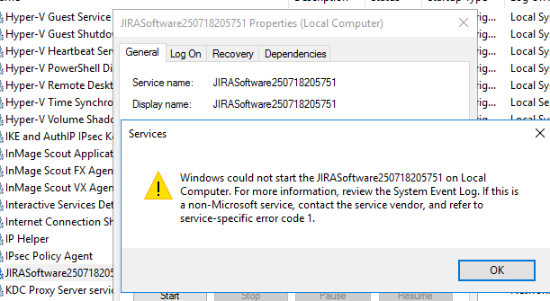

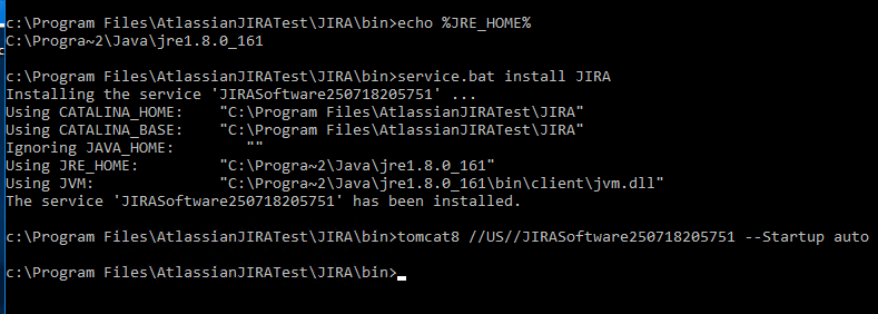

Hi @miikhy- i did before and did it again after deleting the service. Here are the screenshots:
After successfully installing the service and setting it to auto-start. I rebooted the server (Windows 2016).
However, I found the service is still in Stopped mode so I tried to start it, but got the error below (same error I have been having since day 1):
I thought maybe the reason for this error is that when I installed this 2nd JIRA instance, I installed it as a service. I am now inclined to uninstall it and re-install, but this time not as a service so I can set the service manually.
Thoughts, please?

Hi,
The logs you posted seems to be OK. Have you tried the manual install with a different name that "JIRA"? such as
service.bat install JIRA2
That should help? I've just figured you used the default name which might conflict with second service...
Could you also upload the logs (full version) somewhere wo that we could try and search deeper..

I am running into the same exact problem. The first JIRA instance is running perfectly. The 2nd instance runs only when i start the "start-jira.bat" file. When I try to install it as a Service, I get the same error as Dnyaneshwar.
"The JIRASoftware service terminated with the following service-specific error: Incorrect function."
Help would be much appreciated.
Thanks.

Hi Micky - in my case, i have JRE installed in "C:\Program Files (x86)\Java\jre1.8.0_161". My Environment (Sytem) Variable = C:\Progra~2\Java\jre1.8.0_161.
I am using Windows Server 2016 (64-bit). And yes they have different JIRA_HOME, Database, Listening and Shutdown Ports.
As I mentioned in my comment here earlier, the 2nd JIRA instance would run if I start the "start-jira.bat" file. To me that means the entire JIRA installation completed successfully. Also, the JIRA Service would be installed and appear in "Services". The problem is the service won't start.
What could I be missing here?
