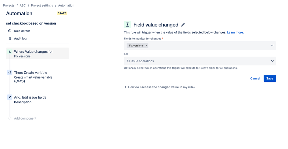

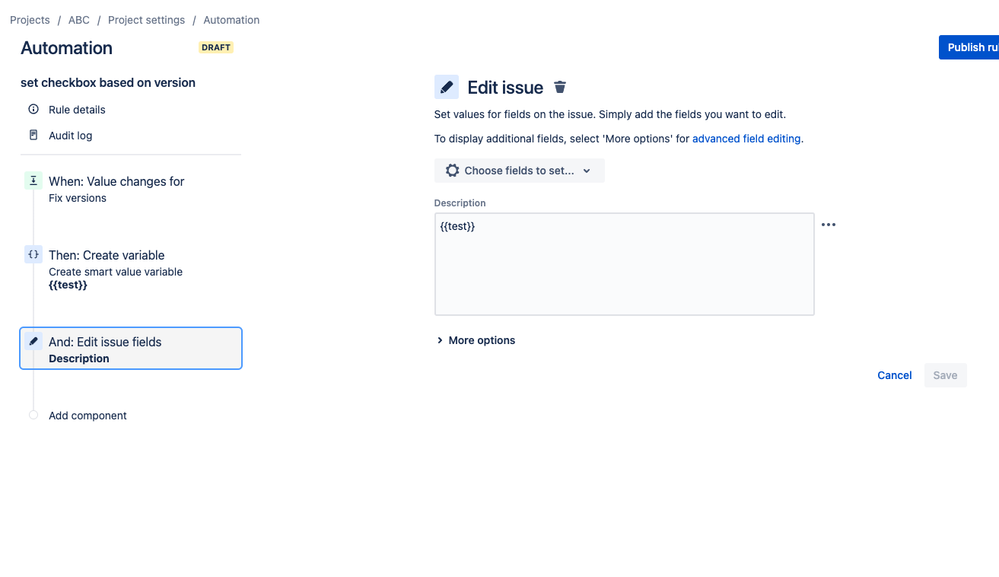

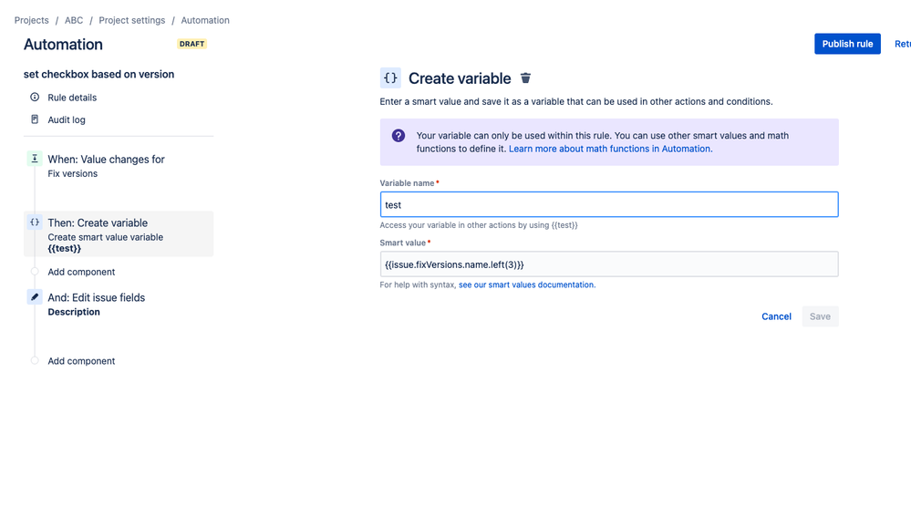

Alternatively, you could look into using Automation rules to populate a custom field with a combined marker,  then use that custom field in a filter statistics gadget.
This would take a bit of set up and trial and error to fine tune the value to fit your exact needs as well as some maintenance over time as new versions are added but As an extremely basic example, you could create a rule that any time the value for fix version is changed, create a variable that takes the left 3 values of the string and populated these values into your custom field used in the gadget.   A quick test would be like the following noting i'm just updating the description for the test but you would want to use a custom text field with this approach:
Screen Shot 2022-01-31 at 3.39.51 PM.pngScreen Shot 2022-01-31 at 3.39.56 PM.pngScreen Shot 2022-01-31 at 3.40.01 PM.png
and as an example of the output, the description is set to 1.0, 1.1 when the fixVersion is set to 1.0.2 and 1.1.1. then using a JQL for "your_custom_field is not empty" used in an issue statistics gadget could get the count using the custom field as one of the field metrics
