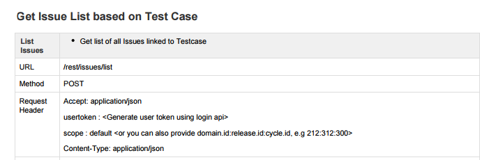

I don't have this addon but you can take a look at this documentation:
https://qmetrysupport.atlassian.net/wiki/spaces/QES/pages/32735628/Integration+through+QMetry+Web+Services+APIs
Look for QMetry 7 API Document

susee_jeeva
September 25, 2018
Hi @Mohamed Benziane,
But what is the base url to access the Qmetry's REST APIs. When i try to use JIRA's base url, it does not work.
Thanks,
susee_jeeva
September 25, 2018
Thanks for your information and quick support. We were able to fetch all our needful information.
