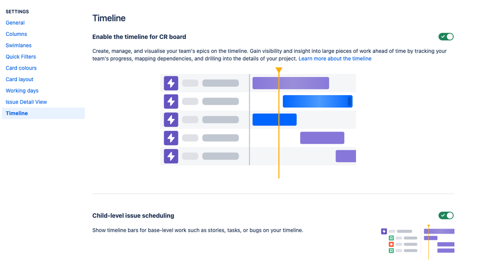

John Webster
October 1, 2023
Go into timeline - select configure timeline and check child entries is selected - its not on by default and you can only drag Epics in
