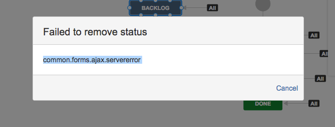

Hey,
I'm trying to delete status from workflow, but I can't because I have error
"common.forms.ajax.servererror"
Then I tried to delete transaction same thing.
Please help

ERashdan
October 25, 2017
Thanks for reply Marko
There's nothing in logs but I found in browser console
DELETE http://my.erashdan.com/rest/workflowDesigner/latest/workflows/globalTransitions 504 (Gateway Timeout)
Marko Filipan
October 26, 2017
Hi Emad,
this message suggests that there is some connection error. I can also notice that you are using proxy; can you please bypass your proxy and try to delete status again?
Here you can find manual which describes how to bypass proxy:
https://confluence.atlassian.com/jirakb/how-to-bypass-a-proxy-and-ssl-to-test-network-connectivity-827328189.html
Make sure to substitute example URL, IP address and port with the real ones in your environment.
Let us know how it goes.

ERashdan
October 27, 2017
Hey Marko
After I delete proxy option "Nginx Proxy" everything work.
So how I can solve it with proxy ?
Thanks.
Marko Filipan
October 27, 2017
Hi Emad,
Below you can find nginx integration guideline for JIRA:
https://confluence.atlassian.com/jirakb/integrating-jira-with-nginx-426115340.html
Can you please go through the guide and ensure that your proxy is configured as advised? There is a possibility that some integration parameters are not configured correctly and that could result in an error.
Thanks.
