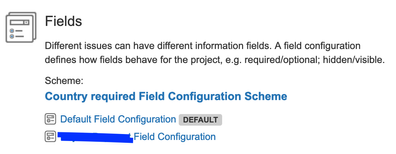

In Project settings I can see my field configuration scheme. I will call the second field configuration (the one I painted over) Blue Field Configuration:

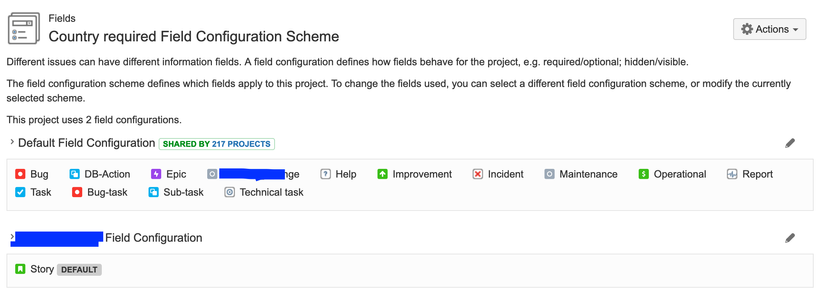

When I click on Country required Field Configuration Scheme I get the 2 configurations and their mapped issue types:

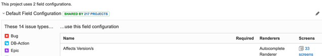

When I expand the Default Field Configuration
Scroll down to Country, I can see Country is not required:

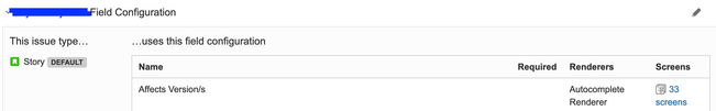

When I expand the Blue Field Configuration
Scroll down to Country, I can see Country is required:Country required.png
