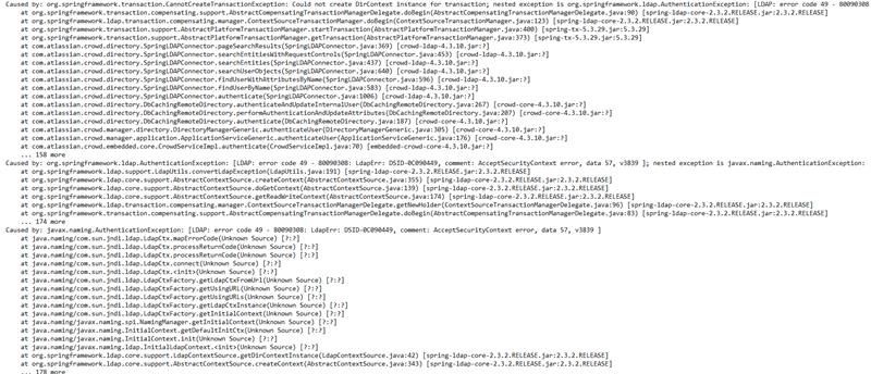

After restoring the Jira DB on a new application server. Unable to connect to our accounts.
2 backup methods :
  • 1- Restore the DB and start Jira
  • 2- Restore Datas in JIRA - update DB - restart
1ae5d2e7-f8d9-4579-b040-29b8b3c10d9d.jpgWhat should we do?

Could you post the log directly here?
The screenshot is not that readable, I can see there is an LDAP_Error but can't make out the full error

I found the solution, I had to reconnect in recovery mode. Reset the JIRA ID and redo the synchro between JIRA and AD.
