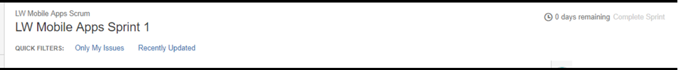

For me the option is visible and blue, but for the two other users it is greyed out, see below:

Ok, as a next step, I would investigate:
  1. Hover over 'Complete sprint' to see the tooltip giving additional information
  2. what's the JQL filter behind the board? Is the filter shared with both of them?
  3. If you are using sub-tasks, check if haven't closed any issues having incomplete sub-tasks associated with them

1. They have this permission yet they still get this error:HoverMessage.PNG
2. They have been given shared rights with the boards and filter.
3. We do use sub-tasks but they don't give me any problems when I complete sprint.
Milan Chheda [INFOSYSTA]
February 21, 2019
It mentions that 'Manage Sprints' permission should be given in all Projects that are available on this board. You probably have issues from multiple projects on this board. In all of those projects permissions, the users should have 'Manage Sprints' access, only then the 'Complete sprint' would be available.

There was a testing board that we forgot was linked to the project so we deleted it and that made it work
