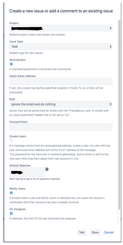

JIRA Settings -> Mail -> Incoming Mail
Mail Server: I have a Secure POP mail server (using Google Apps Gmail if that matters) set up and the connection seems set up correctly given that JIRA is able to create tickets from emails. In Gmail, POP is enabled and when messages are accessed with POP, Gmail is configured to keep the copy in the inbox.
Mail Handler: Handler is set to "Create a new issue or add a comment to an existing issue".

For JSD you do not use the mail handler as you have defined. You should use the following
project > project settings > email requests
the other thing to note is that for replies to result in comments and not new tickets the reply needs to be against the email from JSD not the one that is sent from originator, e.g. might occur if the originator Cc’s others.

ok. so yes the create a request via email for Jira is configured as you have done and appears to be working.

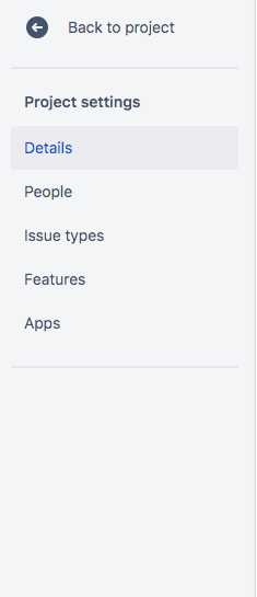

Ah ok I think I might know what the problem is. I am unable to transition an issue created by email because the project has no workflows - just a bunch of boards but not connected to a workflow. I am using a next-gen project, and so I don't see an option to edit workflows. In the project settings, this is all I see, whereas other projects have the Workflow option:
Do you know if there's a way to add a workflow to this, or should I just create a new project and migrate all the tasks?
