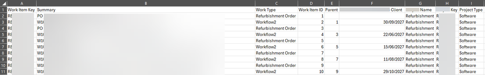

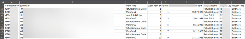

New .csv file -
Previous .csv file -
Noting that both the .csv files had 2 different project keys within.
