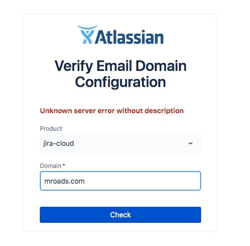

January 10, 2020
Hi Angelica,
We have updated all records as per your instructions. We are getting a new error that is, "
Unknown server error without description" after the update all records.
Please find attached a screenshot of the issue.
Please suggest us to resolve this issue.
Thanks

mroads admin
January 10, 2020

Angélica Luz
January 13, 2020
Hi Bhanu,
I checked https://www.mail-tester.com/spf-dkim-check and there are duplicated SPF entries and the DKIM is missing.
Please, remove the duplicated SPF and add the DKIM. For the DKIM it's not necessary to replace with your domain, just copy from our documentation.
