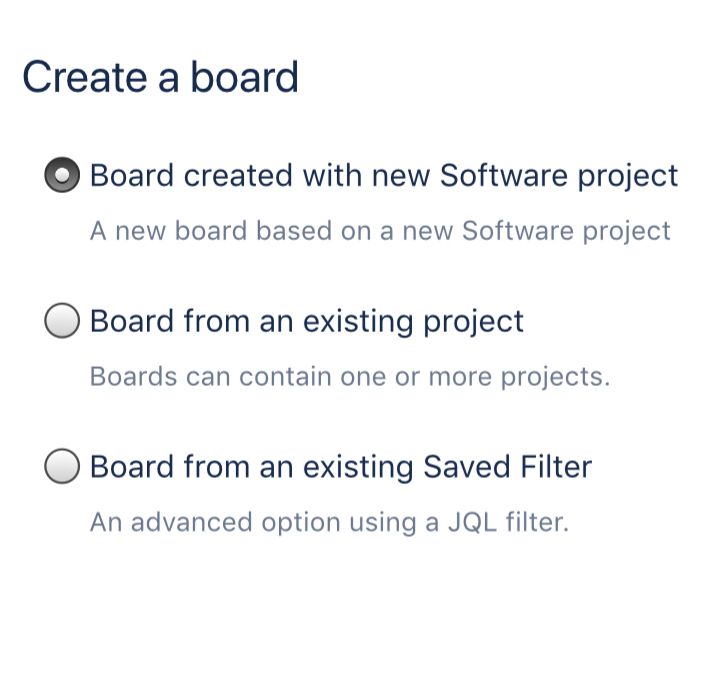

The only case I have ever seen where a project does not appear in the drop down is if the project you are trying to create the project for Is a Business project. Please verify the actual project is indeed a SW project. Note, if you in fact have a Business project you cannot/should not choose the first entry as show below but rather the second.

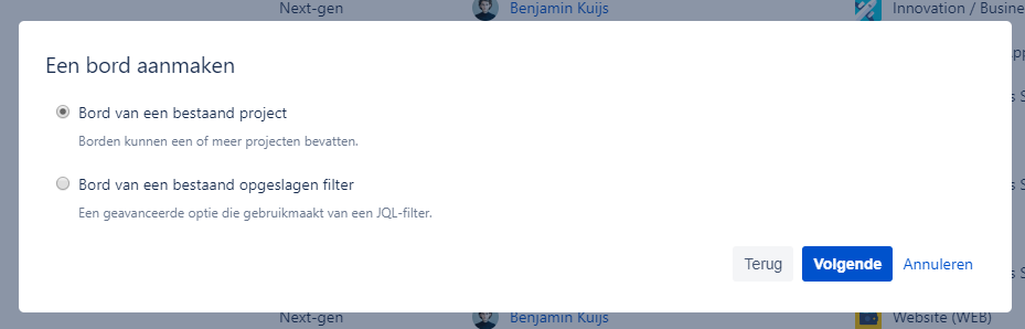

Hi Jack,
As you can see below i don't have the option to select "Board created with new Software project"
Could this have something to do with my user-role / authorizations?
Ok ignore my previous details. It appears you can either chose an "existing" project or a "filter", my Norwegian is poor :-). Are you choosing the "existing" project option to create the board? Assuming so, can you verify that the existing project is indeed a Software project?

Hi Jack,
I've just taken a look at the problem with adding a board to my private projects.
What've found out together with my colleague is that i'm unable to add the boards to a next-gen project.
When we create a classic project it's no problem to add multiple boards.
Have you've heard this before?
yes that is correct. I was unaware this was NG. With that said you can still create boards and, as I explained before for Business projects, placing them under your profile. Then you can add links to the boards using the "Add item" in the sidebar.
