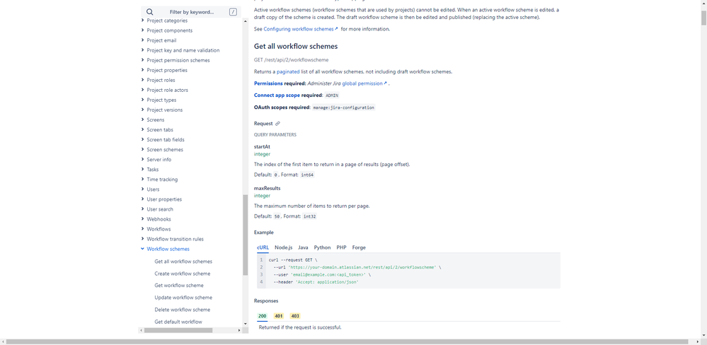

Hello @Charlie Misonne  Sorry I can't make it clear, what I want to say is that for example, I want to Get all workflow schemes, I go to API [/rest/api/2/workflowscheme ] , but I get 404.A lot of interfaces are like this, is it because I have a lower version of JIRA?My current version is 8.13.0image.png

The documentation about this REST endpoint can be found on https://docs.atlassian.com/software/jira/docs/api/REST/8.13.0/#api/2/workflowscheme

I think you might be confusing the cloud and server documentation. As you mentioned version 8.13.0 I assume you are on a server instance. I adapted the tags of your post.
This is the server documentation for your version: https://docs.atlassian.com/software/jira/docs/api/REST/8.13.0/#api/2/workflowscheme
And according to that page there is no endpoint to get all workflow schemes. Not sure why though...

Thank you for your reply. I was confused. There is no such interface in the server document, is there any other way I can get these data?
