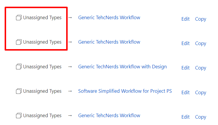

Hello all,
Can anyone tell what's the meaning of this unassigned types in the workflow scheme. I have assigned all the issue types but it's showing this.
My workflows are working fine as I have defined in the workflows but I haven't been able to understand the this unassigned types.
Any help would be highly appreciated. Thanks.

All it means is that you haven't specifically configured any issue types (eg Story, Bug, Task etc) with the workflow, so it will be used for all the issue types that are available in that particular project.
If you want to align a particular workflow with a particular issue type, then you will need to do that with the Workflow Scheme.

It's the default.  It's simply the workflow for the issue type to use when you have not explicitly told a specific type to use a specific workflow.
